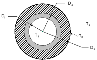

Insulated Pipe
The illustration above depicts a single-layer cylindrical wall of a homogeneous material with constant thermal conductivity and uniform inner and outer surface temperatures. At a given radius the area normal to radial heat flow by conduction is 2 Π r L, where L is the cylinder length. Substituting this into (eq. a) and integrating with q constant gives:

Multi Layer Pipe

From (eq 1) the thermal resistance of the single cylindrical layer is [ ln (r2 / r1) ] / 2rkL. For a two-layered cylinder show below the heat transfer rate is,
Conductive Heat Flow = Overall Temperature Difference / Summation of Thermal Resistance's

The following is the original (pre-7/2016) equations and calculator:
ΔT = (TsEst - Ta)
hs = ΔT - Ds + ΔT2 + Ds2 - ΔT Ds
