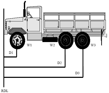

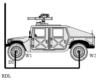

Machine Design Equations, Applications and Calculators This calculator will determine the Weigh and Balance of a trailer or similar application. Units used are in, lbs or mm and Newton's perspective. At the bottom of the webpages, there are several weight and balance application example's.
Conversion: 1 in = 25.4 mm Of course you can use kilograms in place of newton's. To determine the center of balance (CB) and weight locations following the following procedure. 1. Use the following formula to compute the CB location of vehicles. Multiply weight by distance of each axle from the reference line (in inches), and then divide the total results by the vehicle gross weight. The resulting figure is the number of inches to be measured aft from the reference line to the CB of the vehicle. Center of Balance Formula 2. The vehicle CB is computed to the nearest whole inch. Any answer with a fraction of .5 or higher is increased to next higher number. If .4 or less, drop the number. Calculation example #1 Step 1. Weigh all axles individually. Example of basic formula for determining the CB. (Dl x W1) + (D2 x W2) D I from RDL (from forward edge) to center of front axle = 20"
W1 (2,870 lbs) + W2 (2550 lbs) = Gross Weight (5,420 lbs) Calculation example #2 [D1 (15") x W1 (250 lbs)] + [D2 (102") x W2 (2,250 lbs)] Calculation example #3 [D1 (70") x W1 (12,500 lbs)] + [D2 (222") x W2 (12,900 lbs)] + [D3 (276") x W3 (12,700 lbs)] Related:
