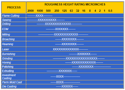

The ability of a manufacturing operation to produce a specific surface roughness depends on many factors. For example, in end mill cutting, the final surface depends on the rotational speed of the end mill cutter, the velocity of the traverse, the rate of feed, the amount and type of lubrication at the point of cutting, and the mechanical properties of the piece being machined. A small change in any of the above factors can have a significant effect on the surface produced.
SURFACE ROUGHNESS AVERAGE OBTAINABLE BY
COMMON PRODUCTION METHODS
PROCESS
ROUGHNESS HEIGHT RATING MICROINCHES
 2000    1000    500     250    125    63    32    16     8     4    2    1    0.5
Flame Cutting
 ---------XXXX----------
Sawing
------------XXXXXXXXXX---------
Drilling
             ---------XXXXXXXXXXXXXX------------
EDM
                         ----------XXXXXXX--------
Milling
               -----------------XXXXXXXXXXXXX-----------
Broaching
                                     -------XXXXXXXX--------
Reaming
Laser
Burnishing
Grinding
                                  --------------XXXXXXXXXXXXXXXXX--------
Honing
Polishing
                                                           -------XXXXXXXX-------------------
Extruding
                          -------------XXXXXXX------
Investment Casting
                               ------XXXX------------------
Perm Mold Cast
Die Casting
                                      ------XXXXXX------
