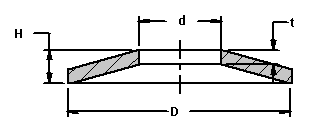

A Belleville spring or washer is formed into a conical or cone shaped geometry. The slight or aggressive conical shape gives the washer a spring characteristic and action. Belleville washers are typically used as springs where the spring action is used to apply a pre-load or flexible quality to a bolted joint. The equations below will determine the various characteristics including the applied load of a Belleville spring or washer.

Diameter Ratio
Diameter Ratio
D = outer spring diameter [mm, in]
d = inner spring diameter [mm, in]

Limit Washer Deflection
h = unloaded height of truncated cone of free spring [mm, in]
Unloaded height of truncated cone of free spring
h = H - t [mm, in]
H = unloaded spring height [mm, in]
t = spring material thickness [mm, in]
