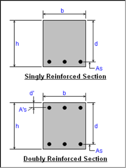

RECTANGULAR CONCRETE BEAM/SECTION ANALYSIS
Flexure, Shear, Crack Control, and Inertia for Singly or Doubly Reinforced Sections
Per ACI 318-05 Code
Hover Curser over Results Value to See Notes
Input Data:
Beam or Slab Section?
Exterior or Interior Exposure?
Reinforcing Yield Strength, fy = ksi
Concrete Comp. Strength, f 'c = ksi
in.
Depth to Tension Reinforcing, d = in.
in.
Tension Reinforcing, As = in.^2
Tension Reinf. Bar Spacing, s1 = in.
Clear Cover to Tension Reinf., Cc = in.
Depth to Compression Reinf., d' = in.
Compression Reinforcing, A's = in.^2
Working Stress Moment, Ma = ft-kips
Ultimate Design Moment, Mu = ft-kips
Ultimate Design Shear, Vu = kips
Total Stirrup Area, Av(stirrup) = in.^2
Tie/Stirrup Spacing, s2 = in.
