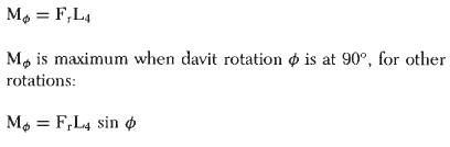

Circumferential moment at guide and support, Mø
